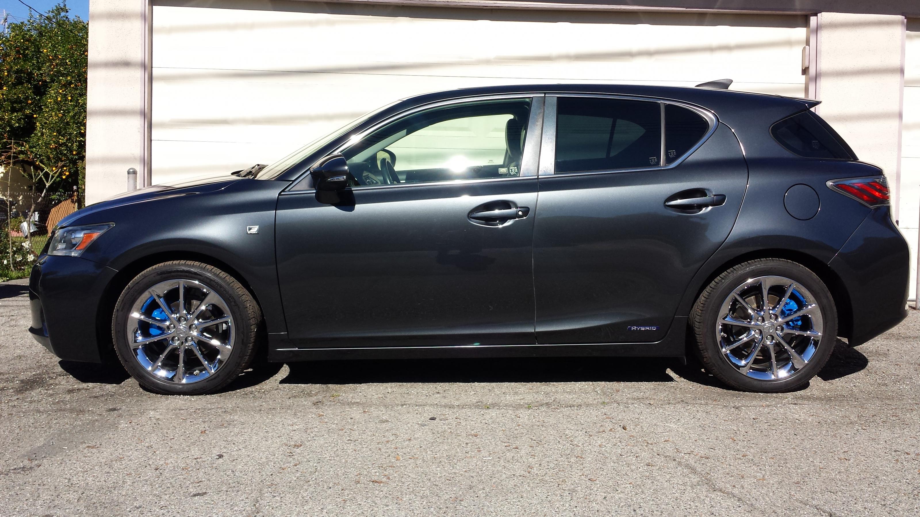

I also painted my calipers blue and it came out great.
Attached Thumbnails DIY : Lexus CT200h painted calipers-ct-w-painted-caliper.jpg
Those look great , that is the color I want to do mine. Did you use the VHT paint or G2?
Thanks! I bought a can of Dupli-color caliper paint at my local O'Reilly Auto parts store. They have various other colors as well. The part number is bcp104.
