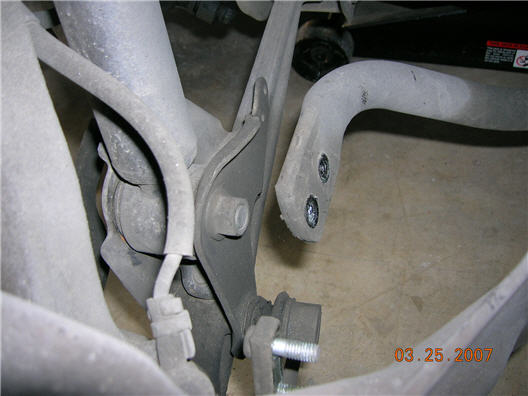

5. Disconnect Stabilizer bar from stabilizer bar link. Remove bolt and nut (although it looks like these are both bolts, one is a bolt and the other is a nut).
![](https://www.clublexus.com/gallery/data/3993/DSCN0798.jpg)

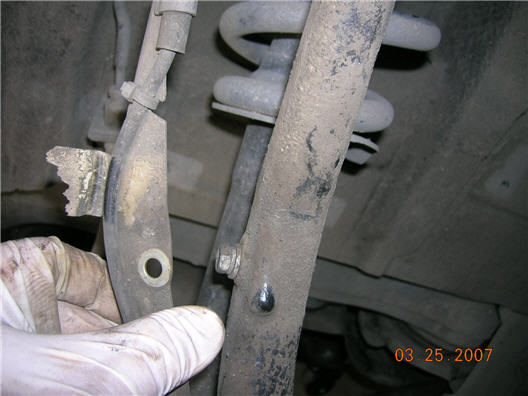

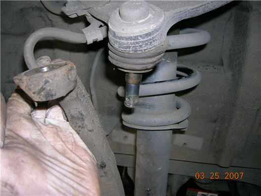

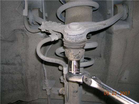

6. Remove the front shock absorber.
Remove the bolt and nut and disconnect the shock absorber from the lower suspension arm. This was the hardest part because that bolt is @#!$Damn tight. I ended up spraying it with penetrating oil several times and using an impact wrench.

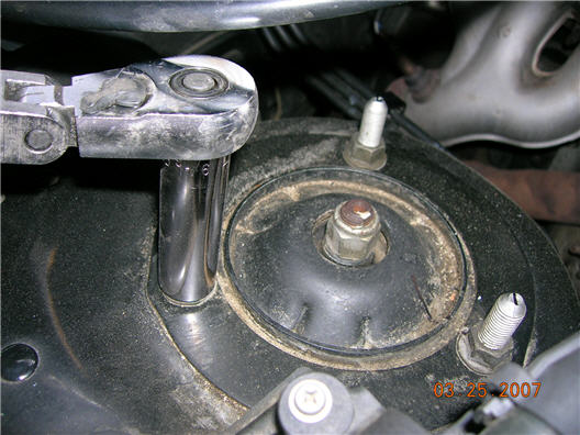

Remove the 3 nuts and shock absorber from the body.
The center nut (piston rod lock nut) should be loosened, but remove it AFTER you put the spring compressors on because it is under high tension.
![](https://www.clublexus.com/gallery/data/3993/DSCN0813.jpg)

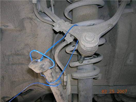

I lowered the jack supporting the suspension so I could lower the arm slowly and pull the shock absorber out.
![](https://www.clublexus.com/gallery/data/3993/DSCN0818.jpg)
![](https://www.clublexus.com/gallery/data/3993/DSCN0821.jpg)
