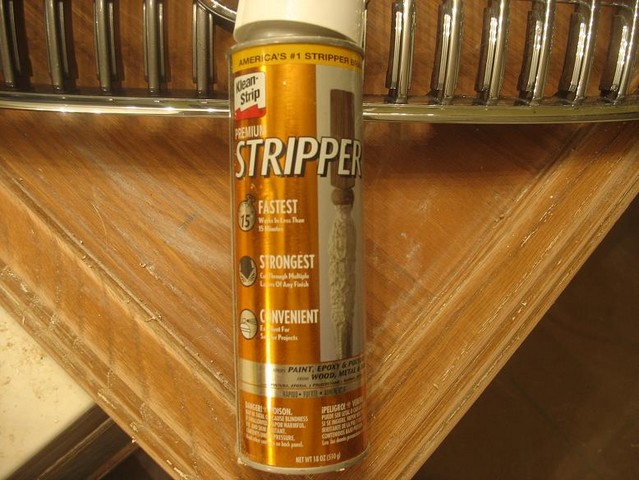

Item used: KLEAN STRIP
please use extreme caution.....very strong product. triple up on safety gloves.

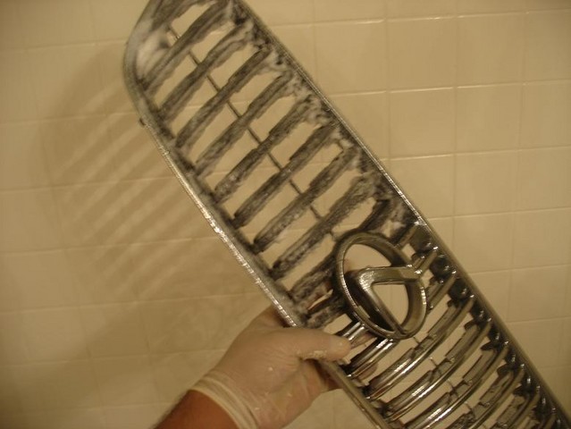

here is a shot of half way done

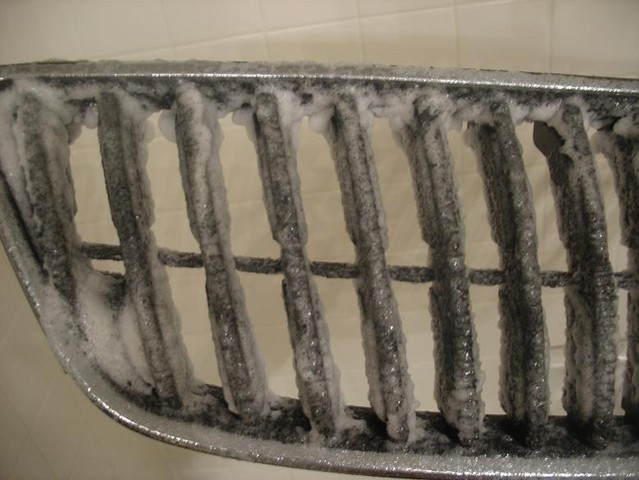

For the "All Chrome Look" simply spray the entire grille. ( make sure you do sides as well)
Let sit for 3 minutes.......you will begin to see paint shrink and fall off.

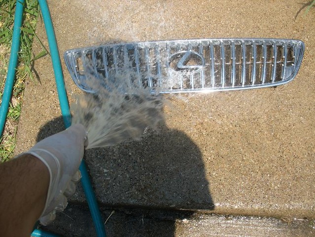

Next, you simply remove paint ( not scrape) using any tool you wish.
to reveal chrome
for best results.....take outside and high pressure hose it off
whallla
and there you have it folks............alll chrome, very easy, very fast.......and ALL CHROME

HOME DEPOT
Lowes discontinued product, so visit The Home Depot.
Make sure you get the spray
Total Time.............about 30 minutes.
Total Cost ..............about 6 bucks
Tools needed..........Safety gloves,10mm socket wrench,flathead and hose.

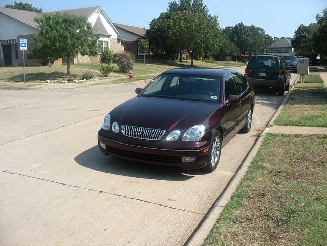

Nice, I have always wondered how the grill would look completely chromed on a Black Cherry. Now I know. I may try this, although having just the slats done looks nice too.

looks like it came out nice now get clear sides to compliment it more

I have been wondering what you have been up to GATO. The chrome looks sweet on the black cherry. Whats next?
