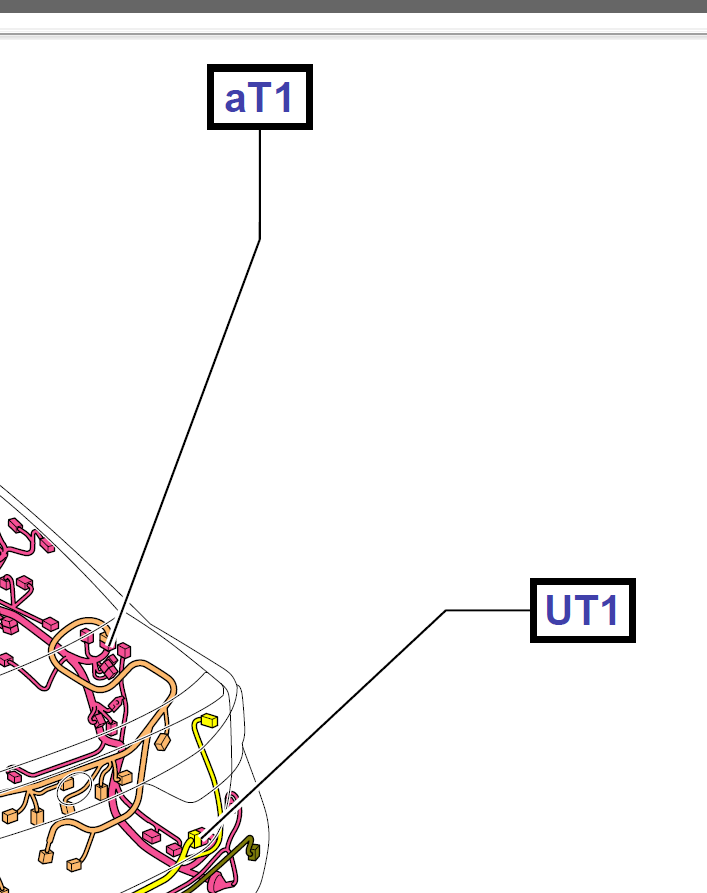

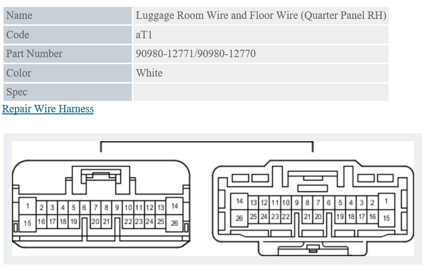

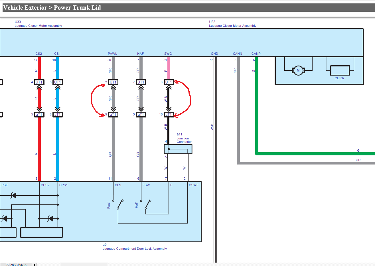

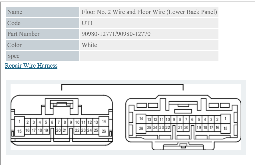

Thanks for all the help guys, I finally figured out the wiring for the power trunk and it was actually easy. Big Thanks to @R6Tuan for pointing me in the right direction. Don't mind the dirty trunk, will have to clean it up now.
Here is the wiring diagram for my 2013 Lexus GS Power trunk.
I used the 2013 power trunk harness:
82181-30320
If you use another part number/year the pinouts/wiring will be different.
For the modifications, all I did was make the connections in the red arrows below from aT1 to UT1. Just cut and wired the connections, super easy.
I guess because 2013 car didn't have the power trunk as an option in the USA these connections don't already exist and that maybe for the years that had power trunk, it's plug and play.
