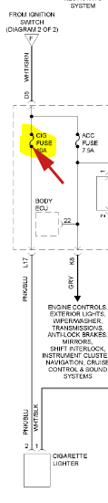

My 04 GX 470 is only used occasionally, in order to keep the battery charged, I bought a solar powered "battery tender" brand charger. The photocell mounts on the windshield with suction cups, the output plugs into the cigarette lighter. The lighter is not powered unless the vehicle is "on". Will the charger back feed the battery even though it's powered off? I suspect it will but would like some advice. I always wish automakers were not such meddling nanny's telling me what's good for me. I would have liked to have been able to charge my phone when the car was parked. While I'm at it, I still can't keep straight the lock/unlock icon on the door switch. A picture of a key on one half and a blank space on the other half. Do you need a key to lock your lock or do you need a key to un-lock your lock? My GM products have an open padlock and a locked padlock for an icon, self explanatory. Must be Japanese logic, culture gap I guess.

You need to remove the Cig fuse, and then inline that same fuse between Batt+ and the Red Arrow tip in this pic. This removes IgnSwitch and keeps Cig socket on all the time. The fuse should be as close to Batt+ as possible, etc.
Requires some re-wire work, but not terribly hard to do, etc.
