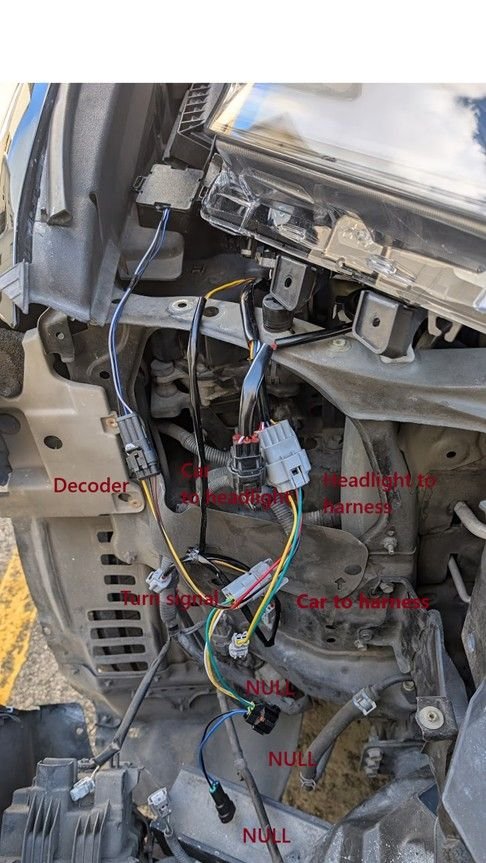

Before I get to the detail, I would like to emphasize couple of points:
1. Those are after market headlights, Not the OEM 2020+ headlights which is NOT compatible with 2014 - 2019 GX.
2. I want thank all the members, especially those had done works with grille that inspired me and contributed many valuable tips, which encouraged and helped me to accomplished this conversion. I never considered myself could do anything involves with “body work”, this was a huge step for me. A big thanks!
Now to the project:
I purchased a set of 2020+ Style headlights from the manufacturer in China. The lights are made for 2014 - 2019 GX, it was a direct plug and play unit with proper harnesses. The lights were very well made, also come with the auto leveling feature. Compare to OEM 2020+ headlights, the after market one also has the DRL combined with sequential turn signal lights with switchback configuration. However, the lights are more likely replicated from European/Asia market OEM unit, it does not have the side marker as in US market. Other than that, it pretty much looks, feels, and functions as OEM 2020+ headlights.
Installation is pretty straight forward, removing the bumper cover as many of members here have done, remove the OEM headlights with four easy access screws, the fitting of new lights are perfect, no difficulty or any mis-alignment at all. Because of the switch back function, the lights also come with a adapter cable, which connects the turn signal light socket to provide turn signal voltage to the headlight unit.
Following are few installation photos, the compare to original lights as mounted:
I spend most of time to figure out what should I do with the original turn signals. Since the headlights has the nice and bright switchback turn signal, by keeping the original turn signal, it is kind of redundant and also looks odd (my personal opinion). I was thinking about to convert it as corner lights which will be activated with turn signal when the headlights were on. But after examine the turn signal reflector, it just not going to have enough light pattern to the corner as it is pretty much designed as a forward illumination. With that, I decided to make it as part of fog driving lights, given its shape and location, it would be nice to compliment the fog, and creat a sort of reverse “L” fog lights combo. So, I made some re-wiring, replaced the original amber LED with white LED, few hours later, here are the results:
