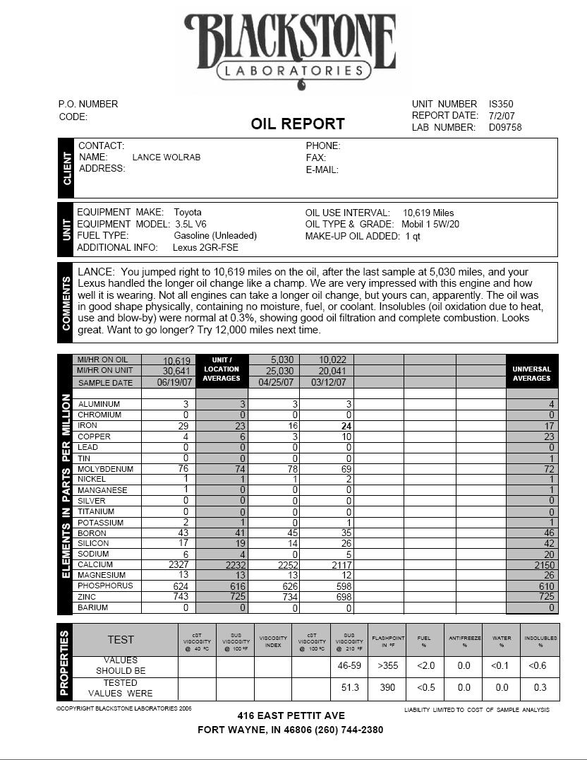

Default Updated OCI Info - Blackstone recommends 12k!
For all you guys who still insist on changing your oil FAR too frequently -
Wow that is excellent! Just curious, but what kind of driving do you do? How much highway and how much stop and go? Also how heavy are you on the ole throttle? 12,000 miles is awesome. I'm assuming you are just changing the filter every 5k and topping off the oil levels like Javy?

This was under absolutely ideal conditions for most of the driving. One trip from Sacramento to Atlanta with only one stop longer than 15 minutes (2560 miles). One round trip from Atlanta to New York City (1800 miles). Many trips from Sacramento to the East Bay (106 miles each way). So, a great deal of highway cruising miles, and very little stop and go. I do floor the throttle fairly often (I never see the black smoke cloud out of the exhaust when I do this), but for the most part I'm in a highway cruise mode. My all time average fuel economy on the display is currently 25.6 mpg. I'd say that's pretty rare for a 350.
I'll be starting a new job that requires I commute ~40 miles a day very soon (I hate commuting, but they're making it worth my while) so these numbers could change significantly. When you get in the car and drive from full tank to reserve light on in a continuous mode, lots of things work really well, especially OCI.
