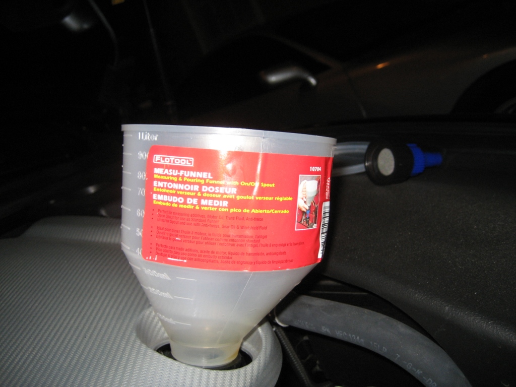

I also bought a funnel at Walmart I think many here will appreciate. See below:
![](https://www.clublexus.com/gallery/data/500/Oil_Funnel_3.jpg)
![](https://www.clublexus.com/gallery/data/500/Oil_Funnel2.jpg)
It comes with a valve and a clear plastic hose so you can measure the fluid before you put it in, but if you unscrew the valve, the threads on the funnel allow you to screw the funnel right into the opening for the cap so you can pour as fast as the funnel will drain (pretty fast!) without spilling a drop. It works great and cost less than $4! It will work on most Scion/Toyota/Lexus vehicles too.
