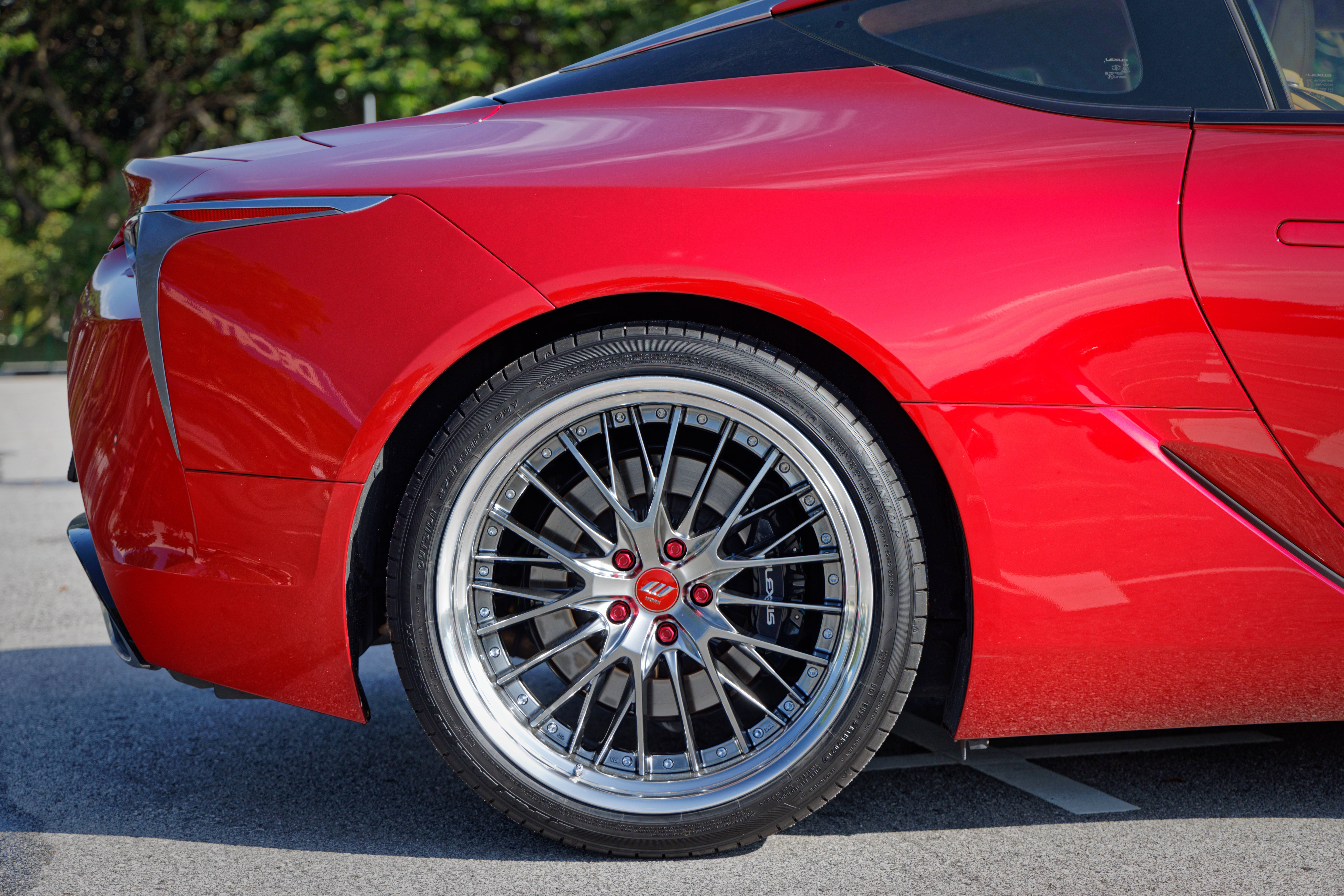

Work Schwert SG2
Face Colour: Glimit Silver (something between gunmetal and brushed silver, to my eyes)
Rim: Polished Silver (Step Rim)
Red Center Cap option which is almost 100% colour match to our Infra-red (there are no wheel nuts that match as well though, mine are forged Rays which was the closest I managed to get to)
Manufacturer Page: https://www.work-wheels.co.jp/en/search/detail/147/
21 x 8.5 + 5 (A Disk) (20mm more than stock) with stock 245/40/21 tires (same width as stock, only offset has changed)
21 x 10 + 11 (O Disk) (20mm more than stock) (slight stretch to fit stock tire, wheel width increased by 0.5 inch)
The rear should work nicely with 285 runflats which is what I intend to run on my next set of rears
Car is not lowered
And in case anyone is wondering, I weighed these and my stock wheels!
Weights are without tires and TPMS/valves
Stock wheel weights:
Front: 15.2kg / 33.5lb
Rear: 16.0kg / 35.3lb
Work Schwert weights:
Front 14.2kg / 31.3lb
Rear 14.8kg / 32.6lb

Sorry for asking over 3 years later....what are the tire sizes for this setup?
Old 08-04-22, 06:43 AM
  #110
breplica
breplica's Avatar
Join Date: Feb 2009
Location: SG
Posts: 242
Received 130 Likes on 60 Posts
Did you mean stock tire sizes?
For the 20 inch wheels:
245/45YR20
275/40YR20
For the 21 inch wheels:
245/40YR21
275/35YR21
