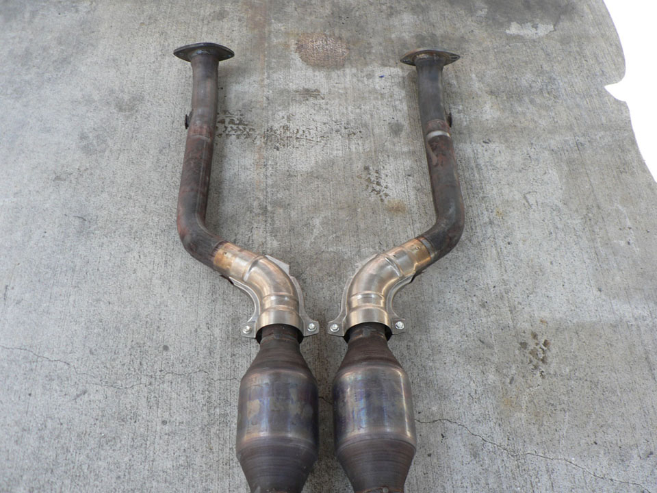

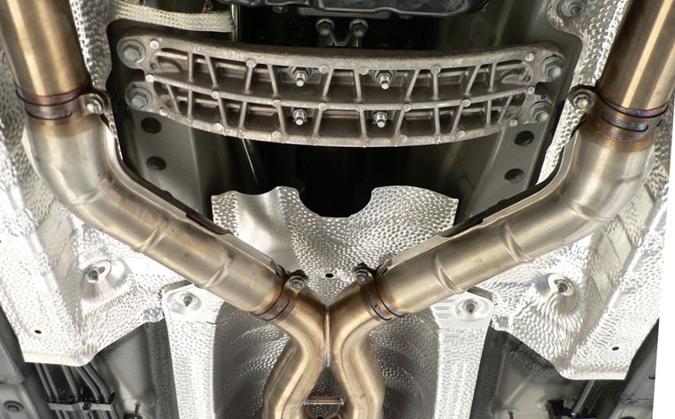

Also, yesterday I had the time to run a short experiment... "caymandive" and I have been talking about this for about a week..
I'll let the pics explain...
For the record the oem piping in the areas around the O2 sensor and before the oem cats is smaller than 2.25 inches...
The oem front-mide pipe has a total of 4 shield sections, held in by 6 bolts with C-clamps and metal pressed clamps on the shield edges.
I managed to transfer 2 shield sections & 4 clamps onto my new front section...
It takes some effort to get the oem clamps to work on the bigger piping, but nothing major... No cutting involved, just some patience..
I guess it has an oem look to it now, good for SMOG visual in 5 years... LoL..
This was done purely for cosmetic reasons at this point, just in case..
Joe Z
