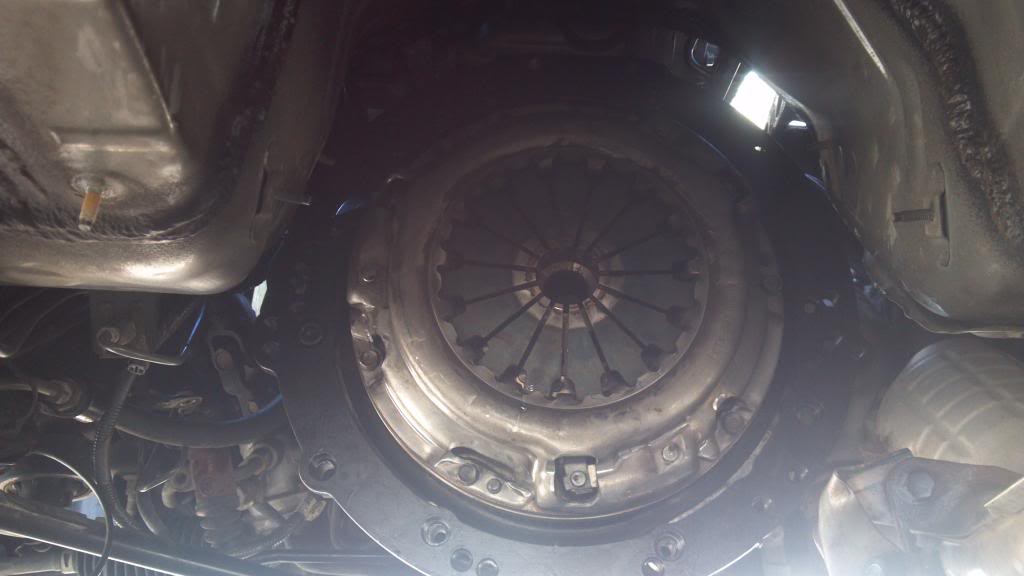

You can forget putting a cd009 in a is300. Starting with the firewall. The opening is too small for the bell housing. The entire tunnel is conformed tightly around the w55 and the w55 is a hell of alot smaller than a cd009. For it to fit you will need to cut the entire tunnel out starting at the firewall and going the full length of the cd009. The cd009 wont even get close enough to make the stab let alone lift up into position. Its missing 3"+ the entire length of the firewall. Even if you moved the 2jz forward a couple inches you will still not make the cut near the shifter opening. A hammer just wont be enough as the entire tunnel is way to small. This can be done by cutting out your current tunnel in its entirety and welding in a new tunnel to the floor (drift car / race car). 6k for a v160 is out of the question so im dumping this project for a better chassis.
Adapter plate with 2jz hanging as far as it will go on loosened motor mounts and subframe. Imaging lifting the 2j into driving position....no chance.

IS300 tunnel is around 5-6" most of the way wheras the cd009 needs 8" just to fit 9" to be comfortable. These measurements are with the padding removed, even less with shown padding.

See what im saying.

W55 barely fits, cd009 no chance.

See what im saying.
