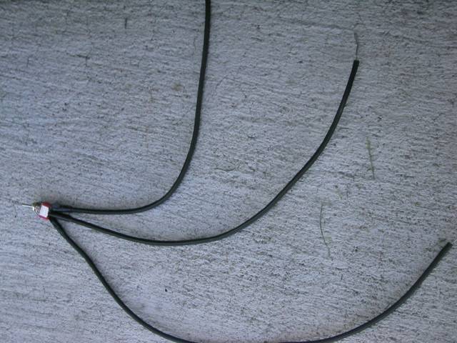

First I wired up a little contraption to make the switching easier. It is a switch with 3 prongs terminals to which I have attached some wire. I will call each connection A, B, and C respectively.

I unhooked the diagnostic port from the foot panel to make it easier to deal with (It's like unscrewing the car light bulb). When it was time to clear the AIR BAG light, I plugged stripped the wire from the switch I made into the pinholes. I plugged the A connection into the TC pinhole and plugged the C connection to the AB pinhole. I just stuck the B connection into the door hinge for a good ground. ciruitAB should be set before the key is plugged in.
Here is the setup all wired up.
