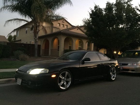

I'm already in the first post, but here's more details.
CL Member Name: Jeremyp111
Rim Brand and Type: HP Evo
Rim Size f/r: 18x8 (f), 18x9 (r)
Rim Offset f/r: 38mm f&r
Tire Size f/r: 245/40/18 (f), 265/35/18 (r)
Suspension Setup: Tein Basic Coilovers
Comment On Ride: Nice and smooth. It's much firmer than stock with the Teins and 18's it rides well IMO
Fender Modifications: None
Any other comments: I absolutely love the HP Evo's on a Platinum SC. I'm not sure yet if they clear TT or LS400 4 piston calipers, but I will soon find out. Still running stock brakes for now.Picture:

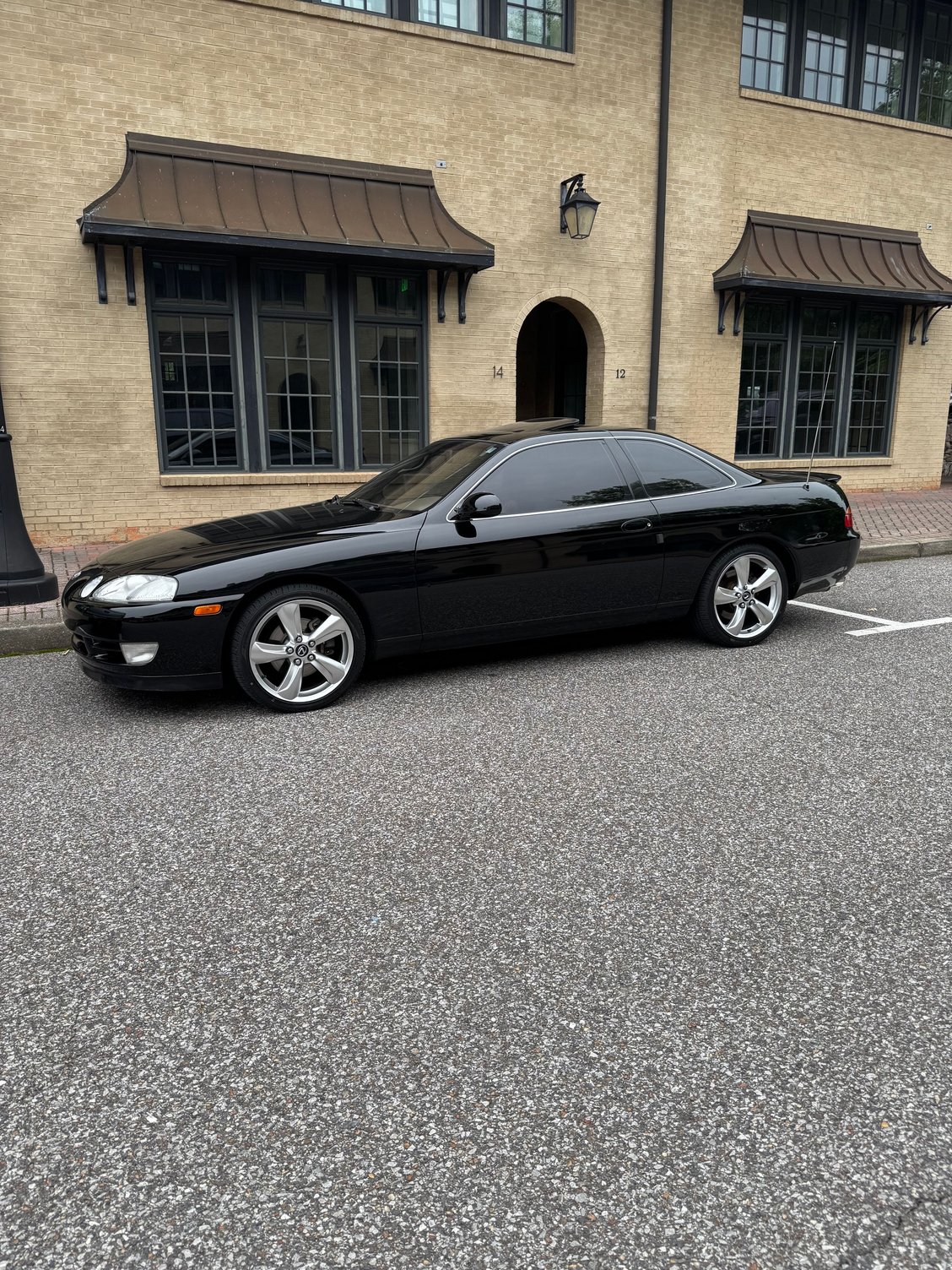

I've been up and down this thread but haven't found an exact numbers. Currently running 18x8 +35 with 225\40 FR 245\45 RR
I'm looking at some 18X8.5 FR 18X10 RR +20 wheels. Will be installing ls400 bbk soon. Any recommendations on tire sizes? Will offset be an issue? I'm on maxpeeding coilovers, not lowered a ton. I don't mind rolling fenders🤏, but cutting is a negative pls👎

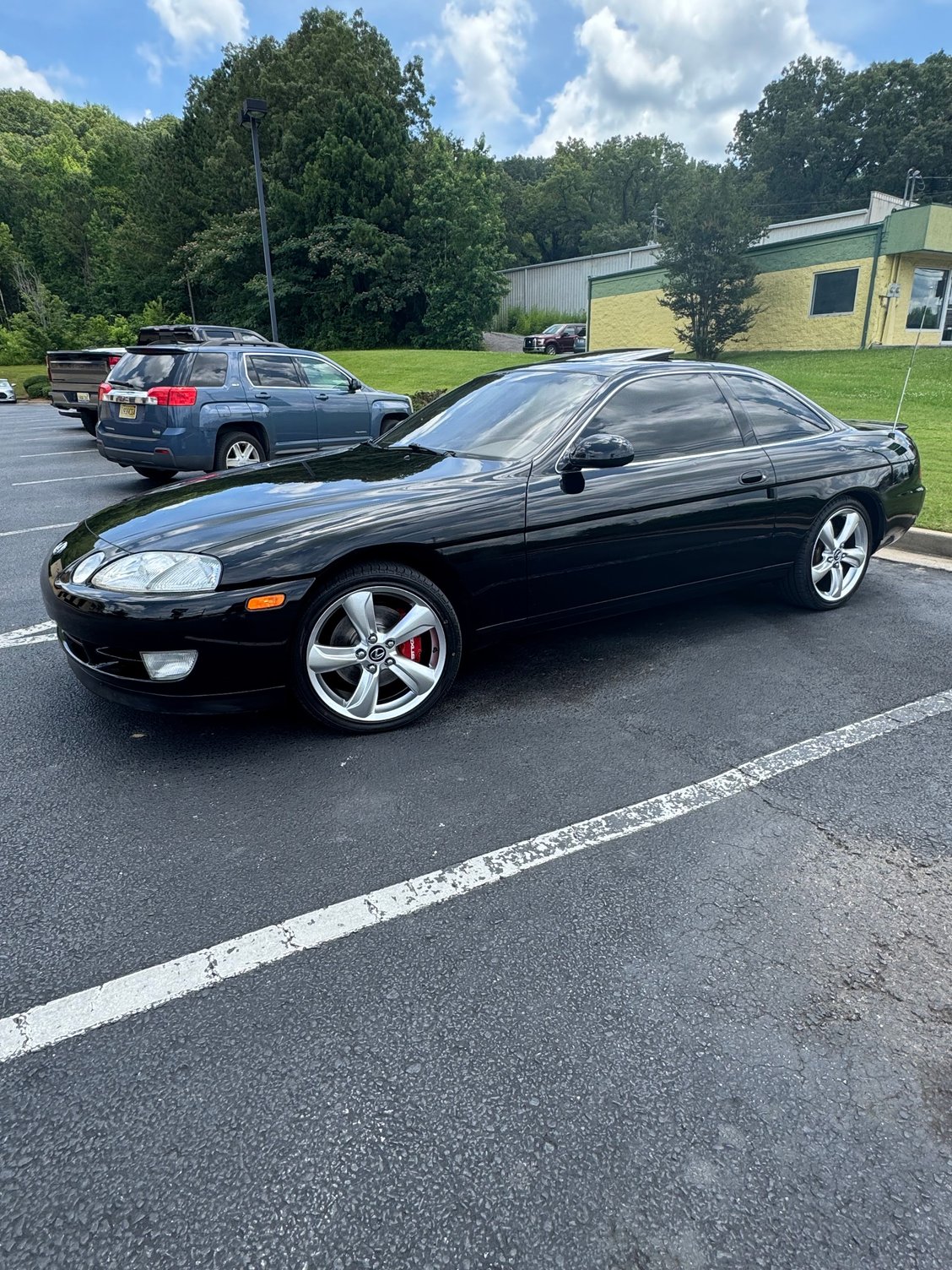

I'm looking to get 245/40r18 all around with a 2 finger fender gap on 18x8.5 +38 wheels. With a 2 finger gap, does anyone think that fender mods would be necessary? I'm currently on adjustable coilovers at max height (Tein Flex Z) and running 235/45r17 front and 255/40r17 rears (Supra TT oem wheels & tire sizes) and have never rubbed or scraped. I don't mind a bit of gap or if it's a bit flush b/c this car is still a daily, but want to go as low as possible while still avoiding any scraping and I don't want to roll/cut my fenders.
Took my a damn year but I finally did put the described wheel/tire combo on. Tires get very close to the front fender liner at full left/right, might touch slightly but honestly shouldn't be an issue. Both front & rear wheels are slightly sunken, up to about 2cm from the fender. I'll be getting my coilovers lowered when I get my rear swaybar installed (have everything on hand, fingers crossed I don't sit on my *** for another year) and am willing to roll my fenders, but does anyone know how low you can go before you need to do your electrical harness re-route as well? I've had to do some wire work for my windows and have noticed the wires & wire casings are really showing their age with how brittle they are, and am worried of breaking wires if I have do tuck them up in the engine bay.

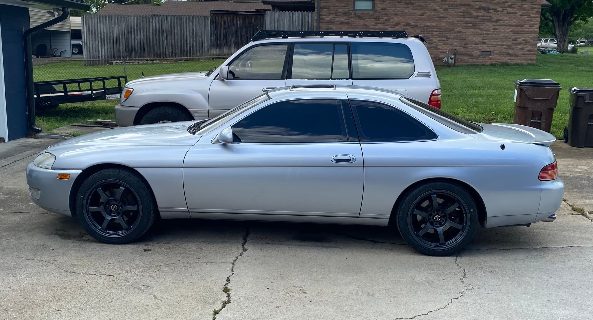

Figured I'd throw my setup on here. 18x9.5 +27 255/35 18x10.5 +30 265/35 Enkei NT03
Just got my fenders shaved so I'm gonna try to max out the camber on the stock control arms and go a bit lower. Almost never rubbed at this height with stock fenders, though. If I did it again I would have gone 235/40 on the front and I probably would have saved a bit more for some Work Meister S1s. Pretty good for my first set of wheels though I think.
This last picture is before I lowered it again. At this height I never once rubbed. This is also with almost no camber.
