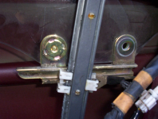

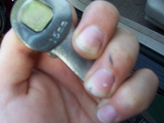

Today my window started acting up.
It still slid up and down but at variable speeds and with some jerking.
This thread was definitely a lot of help (Thanks OLT!)
First I had a fun time taking off the panel.
For the life of me I couldn't figure out what was holding the handle.
Had to come back and found out about the plastic cover behind the handle that conceals the last bolt.
I took some pictures ( kinda fuzzy ) so here they are:
One of the bolts that holds the window to the regulator is out:
A look at one of the things? that holds the window:
In the back it's a square that I was able to get off with a 15mm open end wrench:
MY cuprit:
Turns out in my case it wasn't the regulator.
One of the threads of the cable had snapped and got tangled.
Once I untangled it and cut it off, the window resumed normal operation.
Once again, thanks OLT.
Without this thread I wouldn't have gone in myself.
