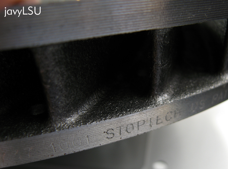

I see these terms misused a lot here...
The F-Sport Big Brake Upgrade is a blue rebadging of StopTech's offering for the 2nd gen IS. If you need more than my word on this, here's a photo I took of the F-Sport drilled disc when this kit was unveiled at SEMA 2007:
StopTech makes the kit exclusively for TRD USA, and it is now only available for sale through the TRD/F-Sport supply chain. You can indeed run this BBK without going to a 19 inch wheel. In addition to the compatibility with the OEM Lexus 18' wheels, CL member t0e has the original StopTech kit (which was available before TRD's deal with StopTech), and he's running 18 inch Work wheels:

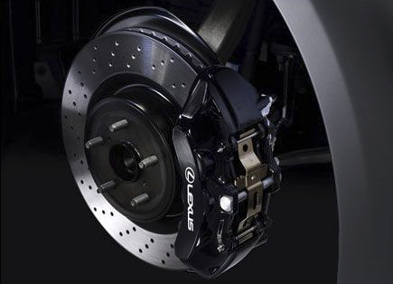

The IS-F brakes (or BBK, pictured below) are the brakes that come standard on the IS-F. They are NOT an F-Sport offering. These are monoblock six piston calipers manufactured by Brembo for Lexus:
Hope this clears up some of the confusion.
